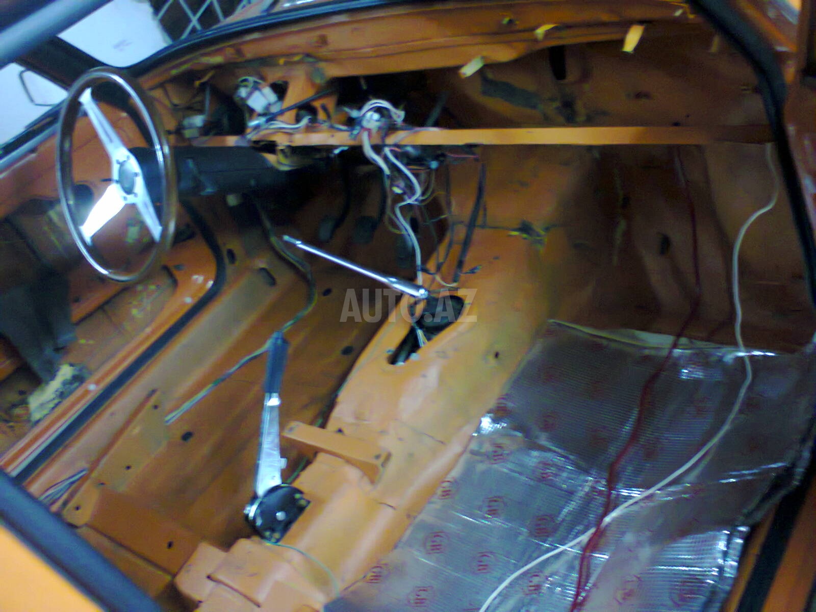

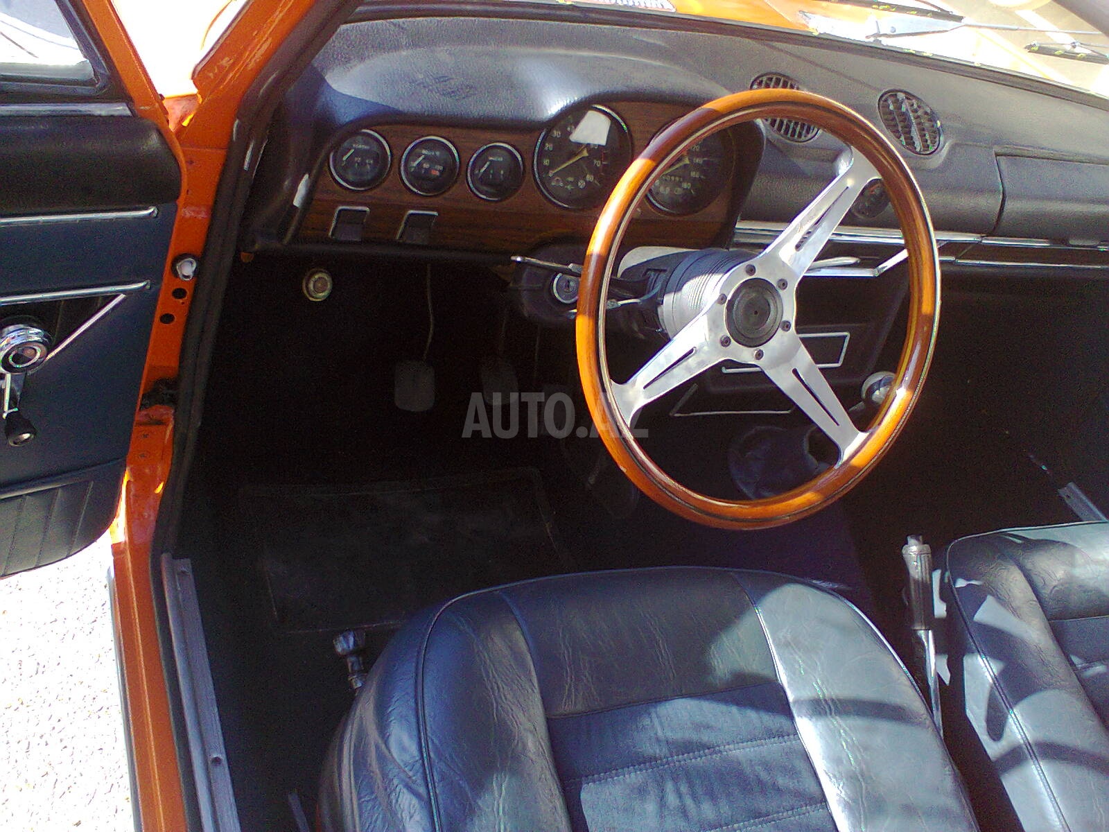

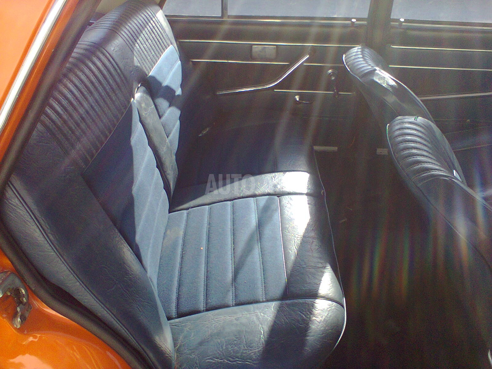

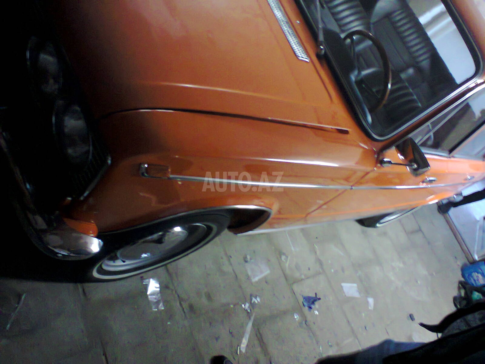

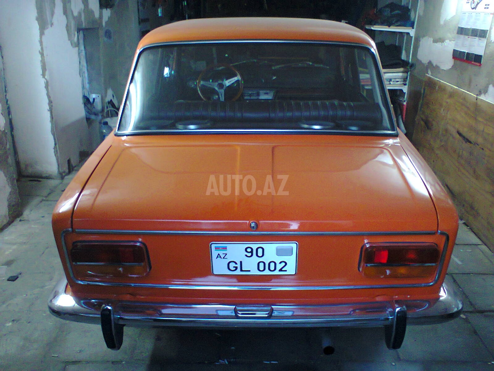

Obeshumka Vaz 2103.
ish tam qutarmayib.wekiller olacag.

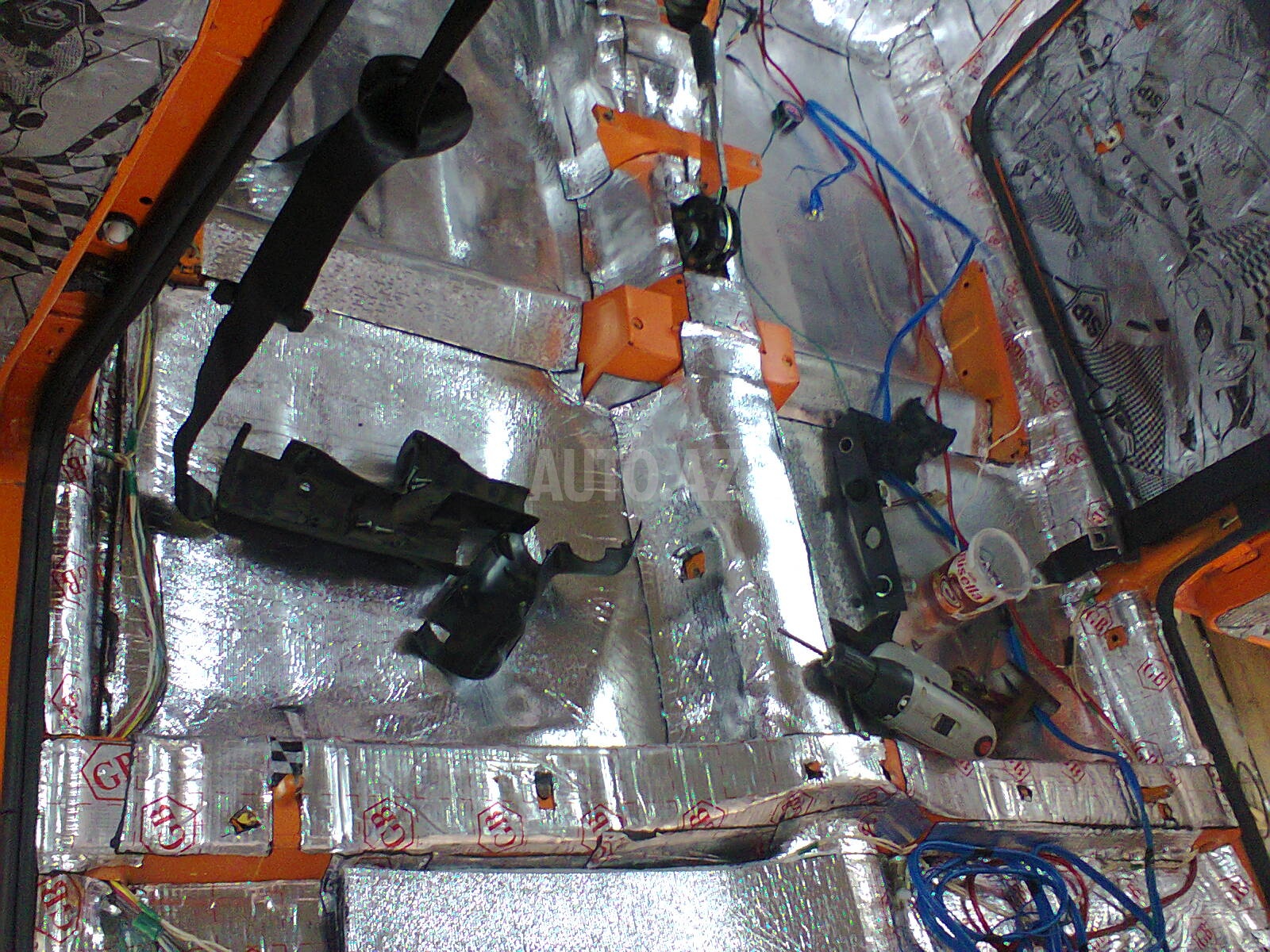

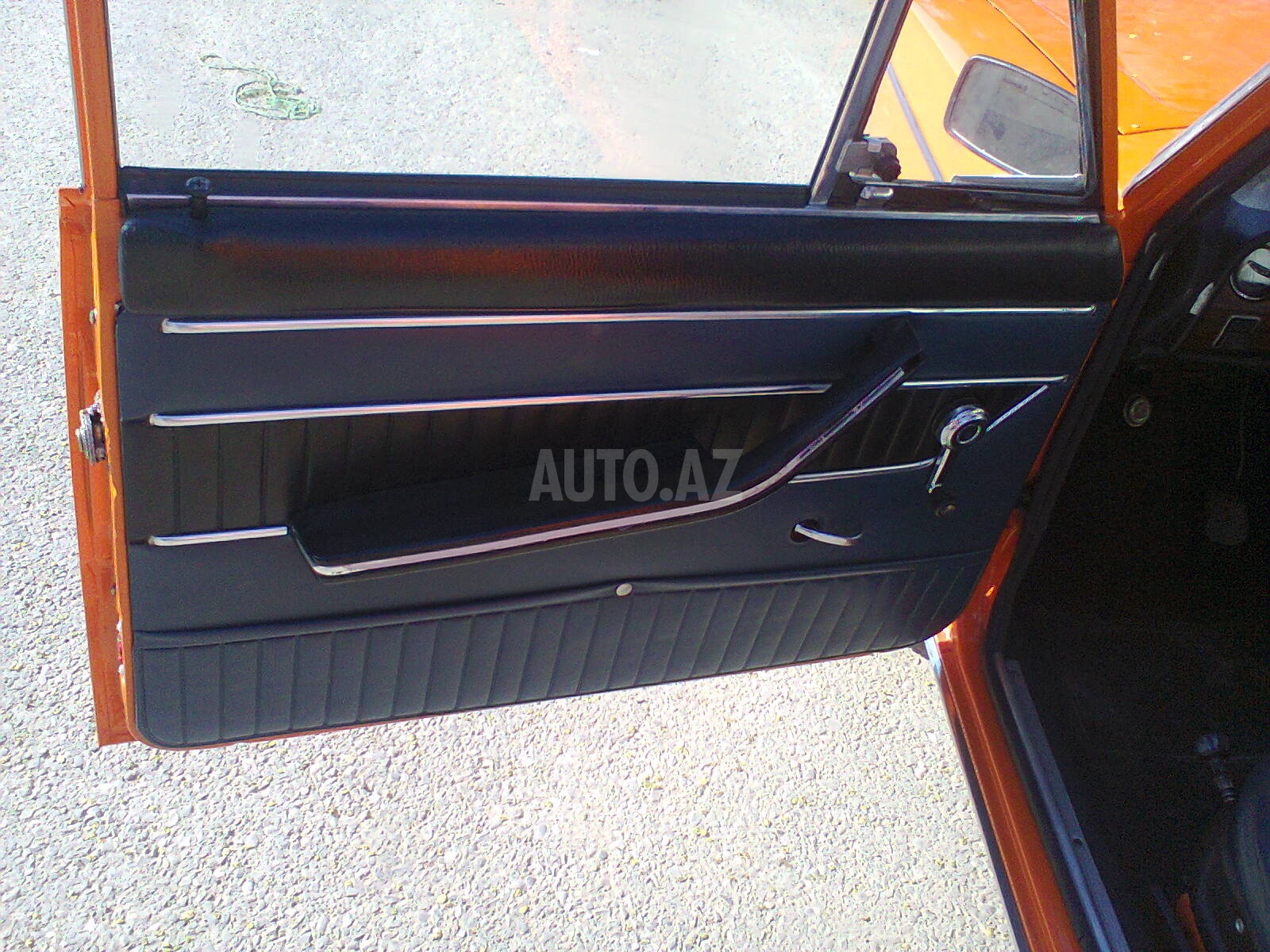

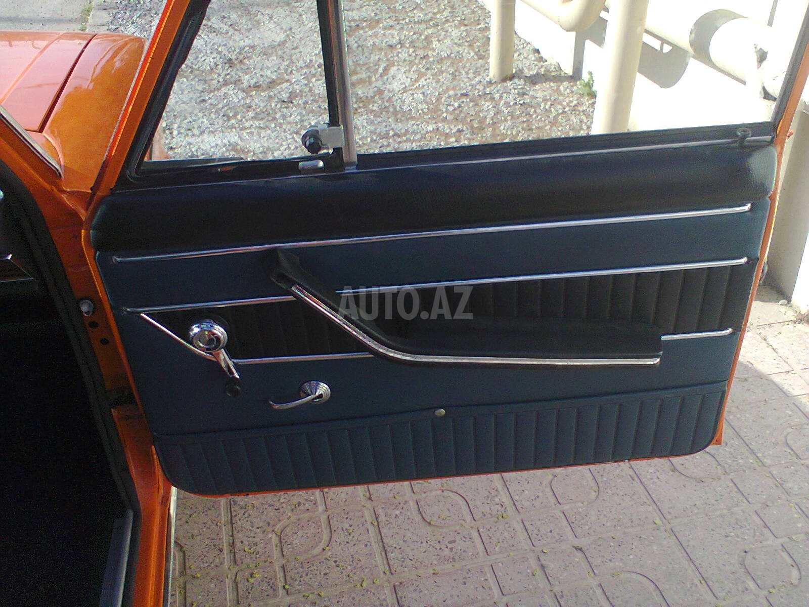

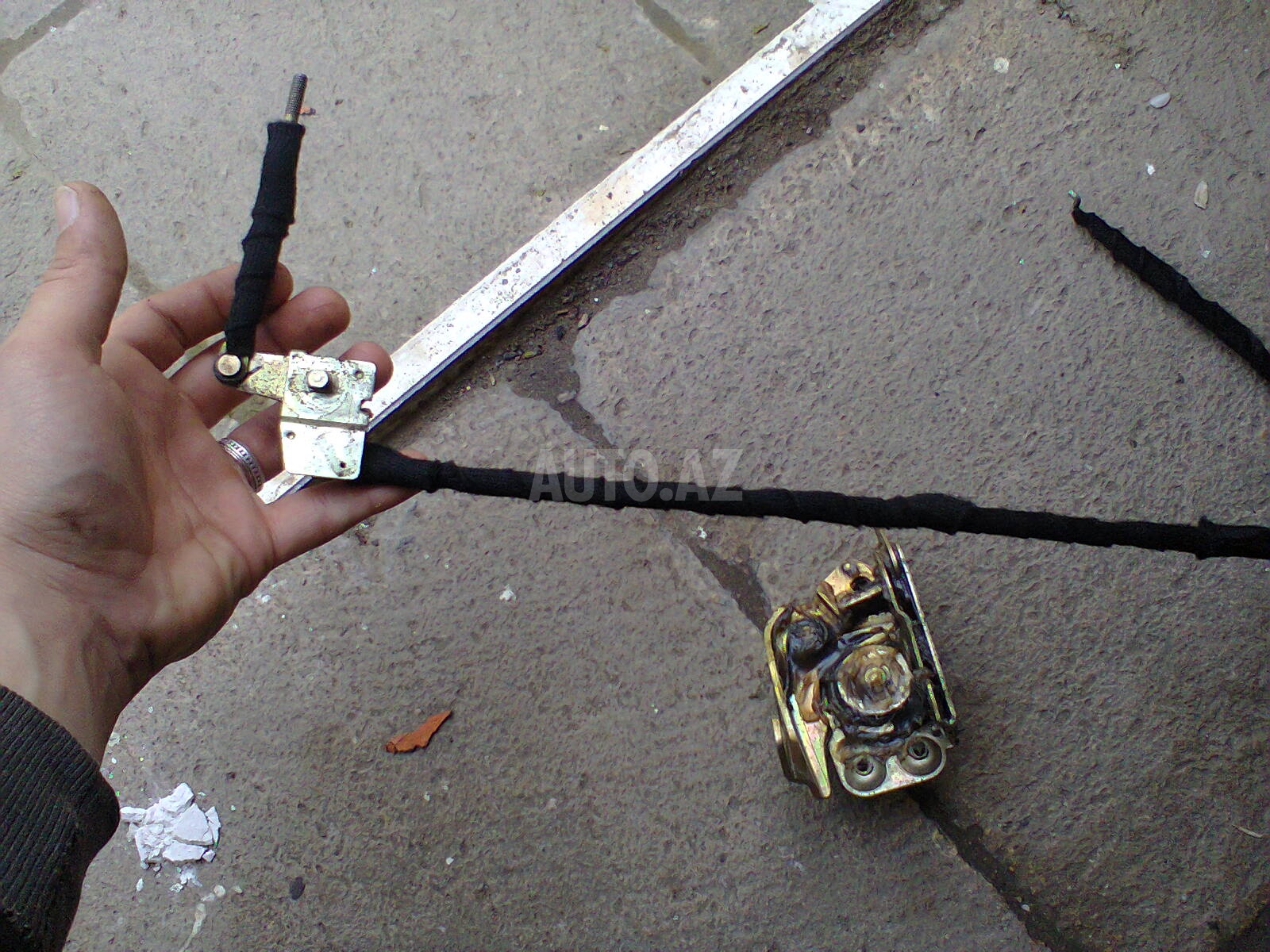

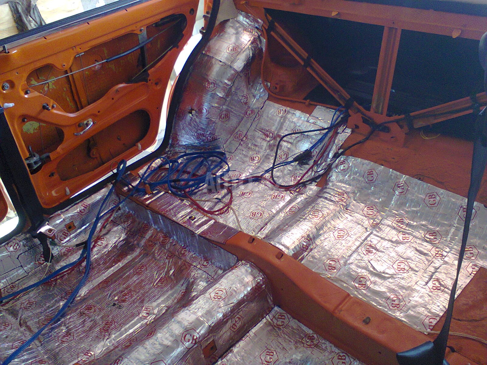

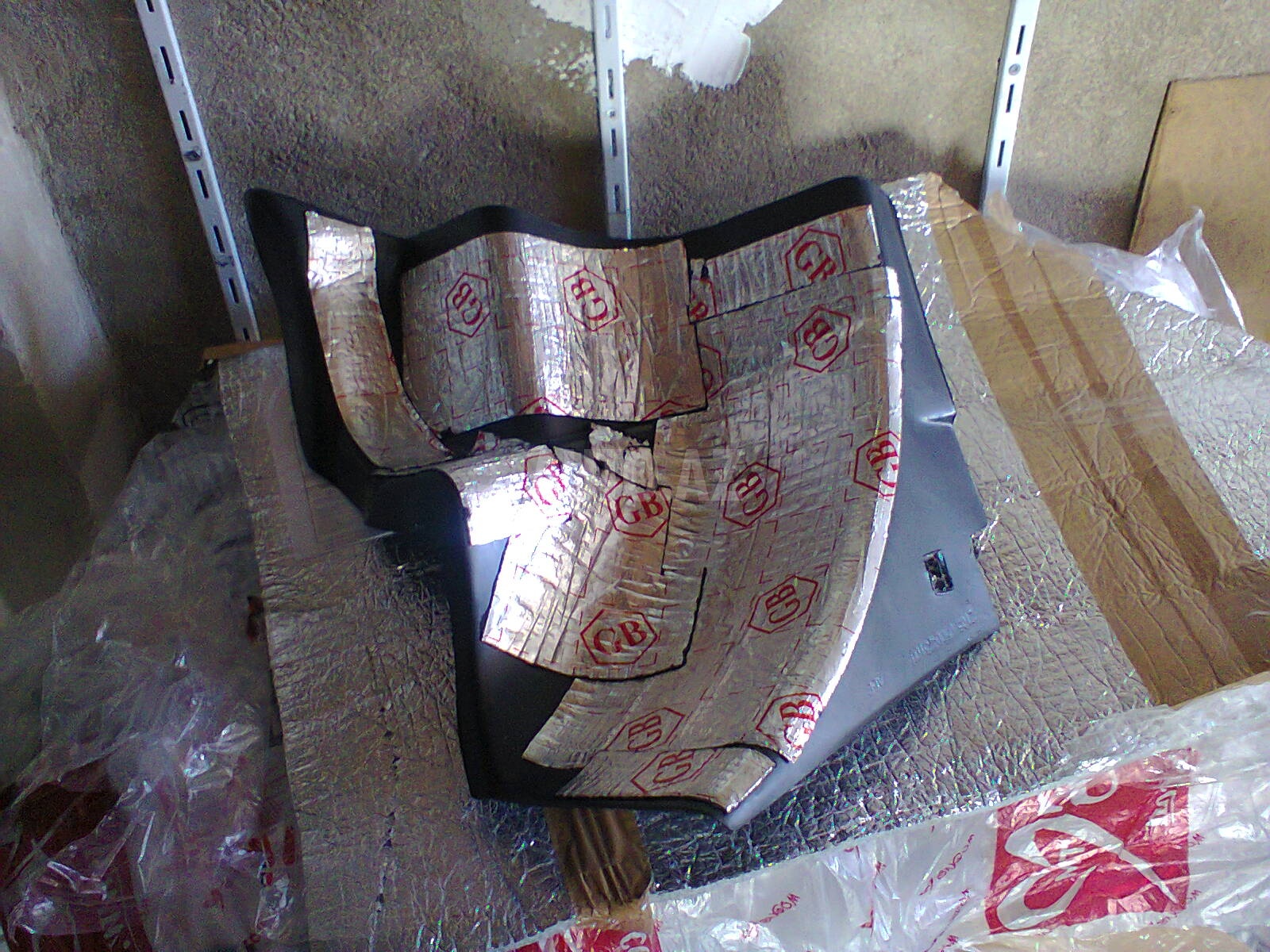

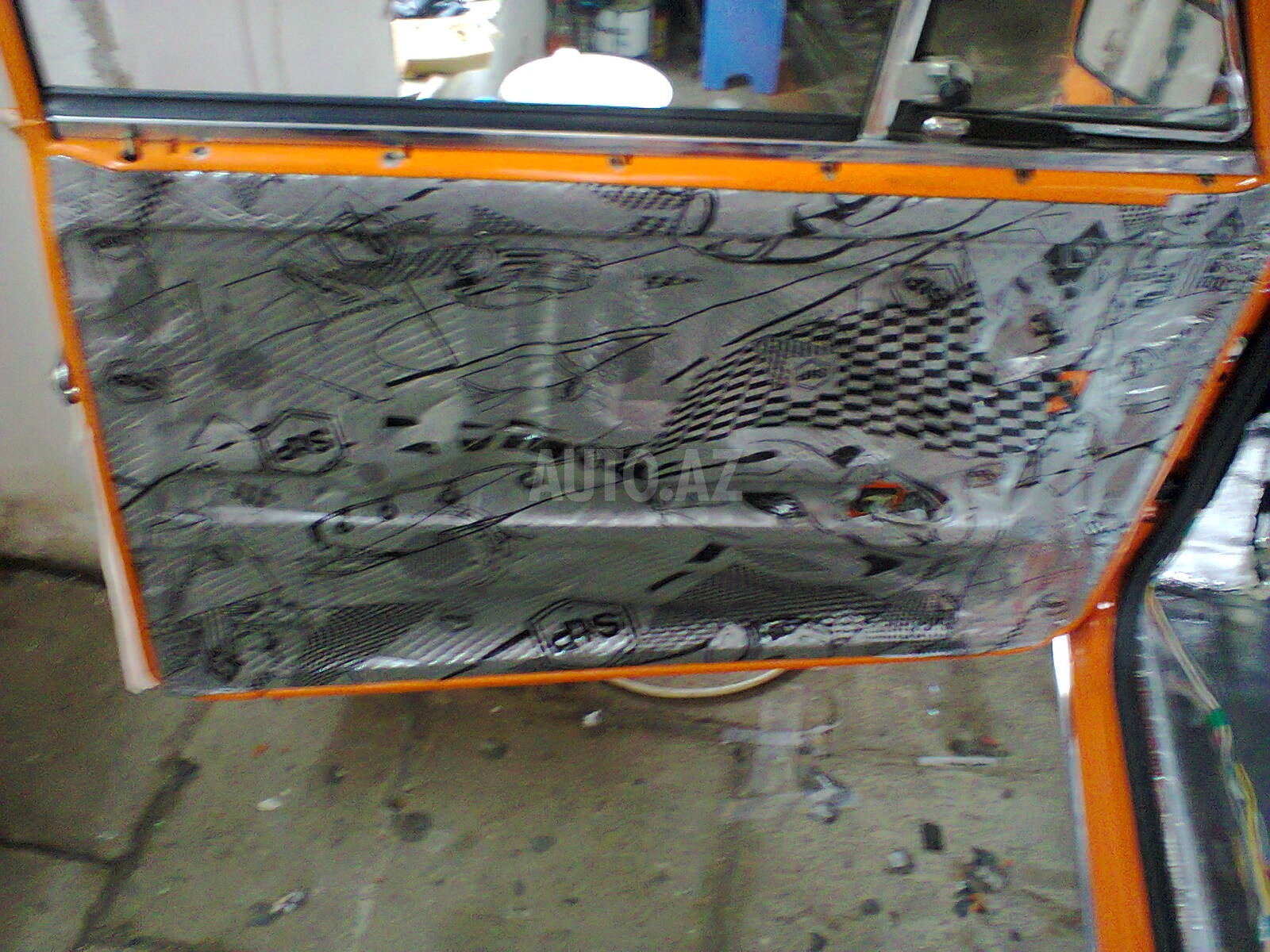

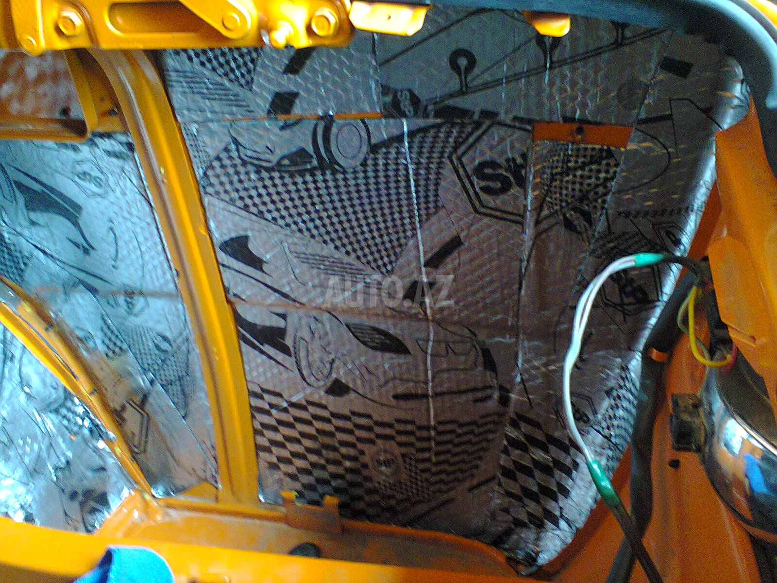

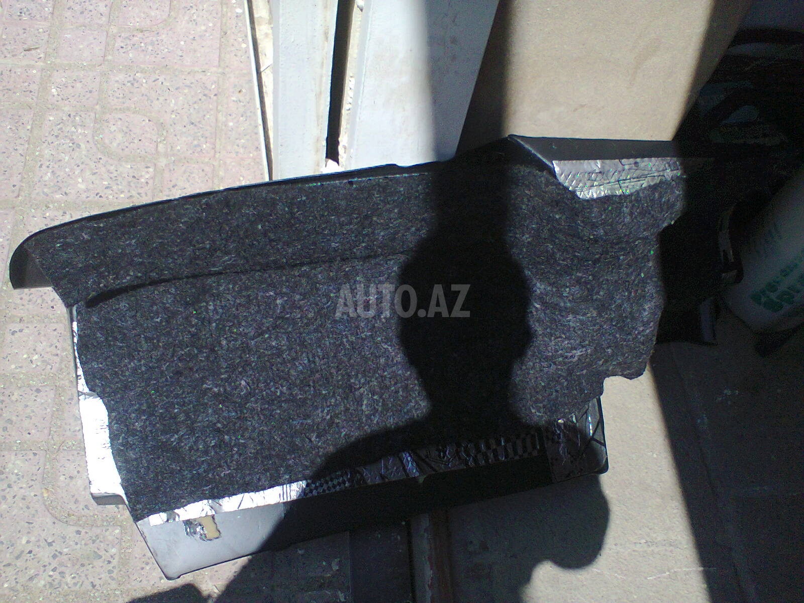

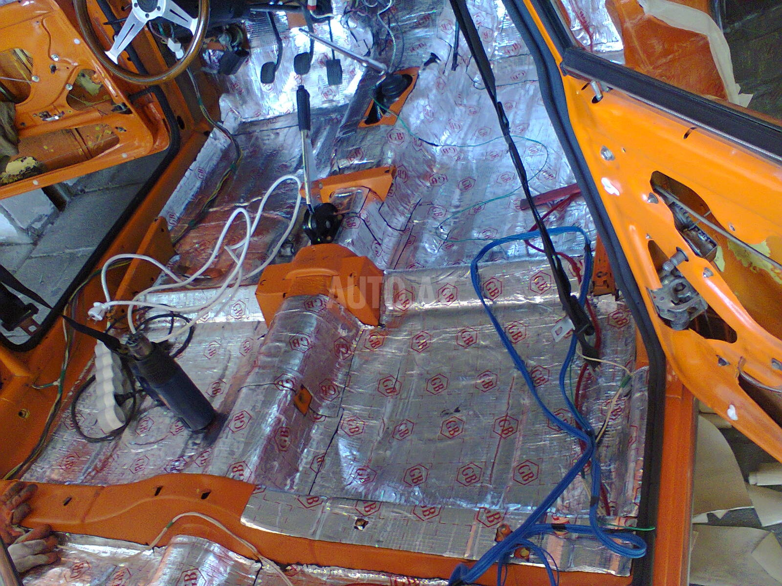

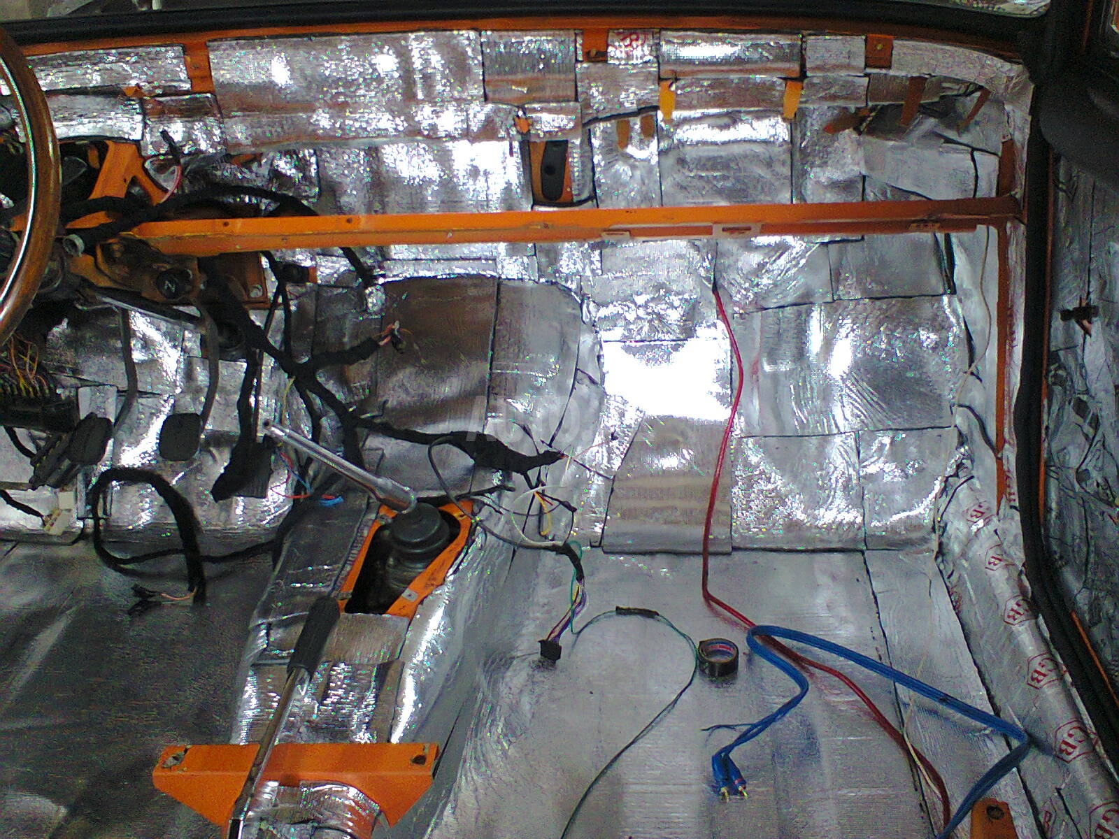

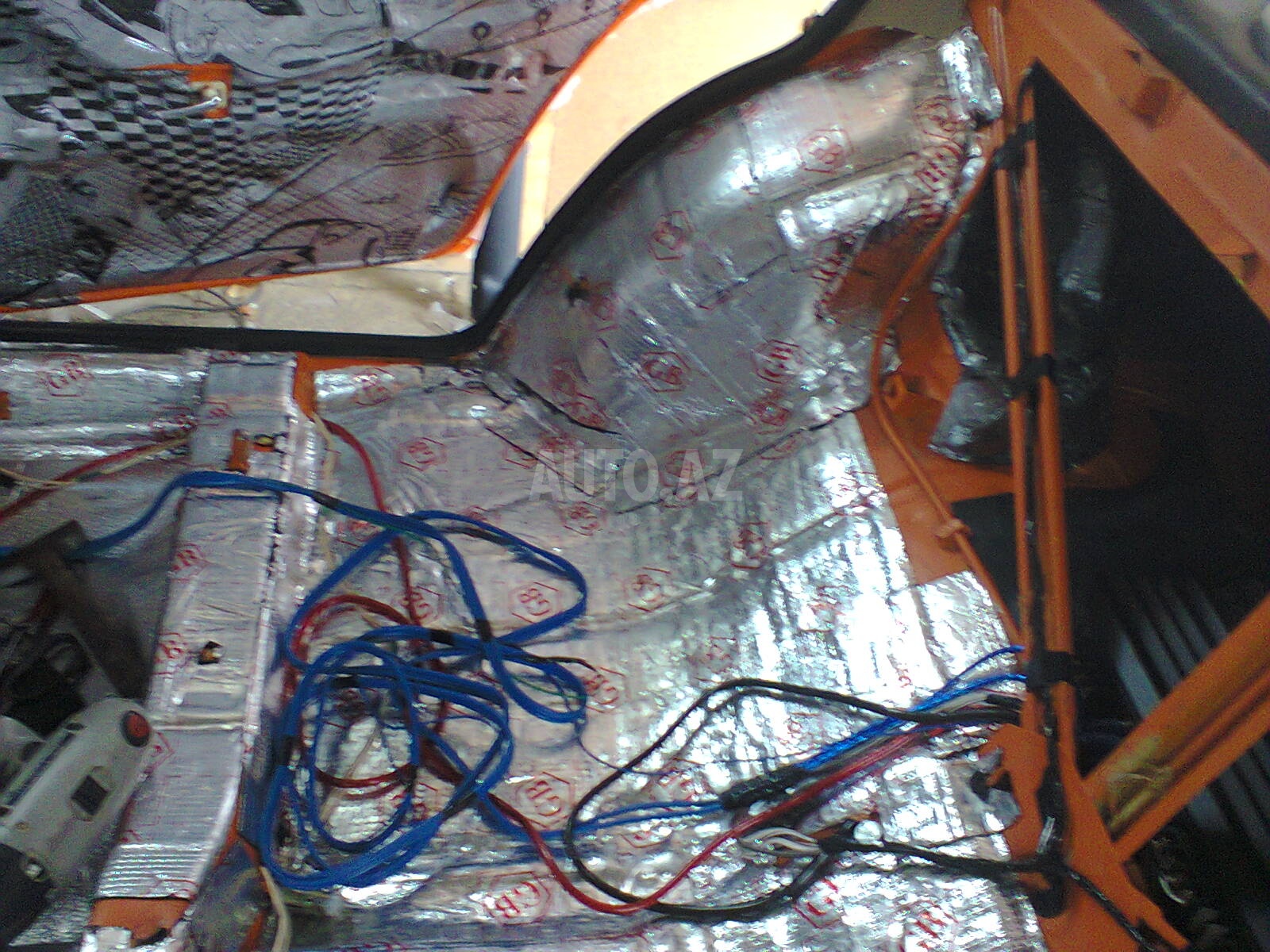

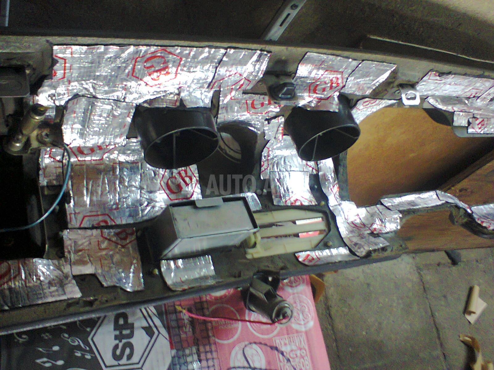

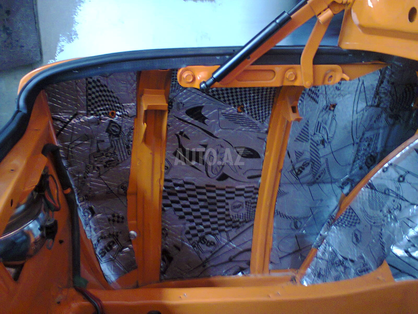

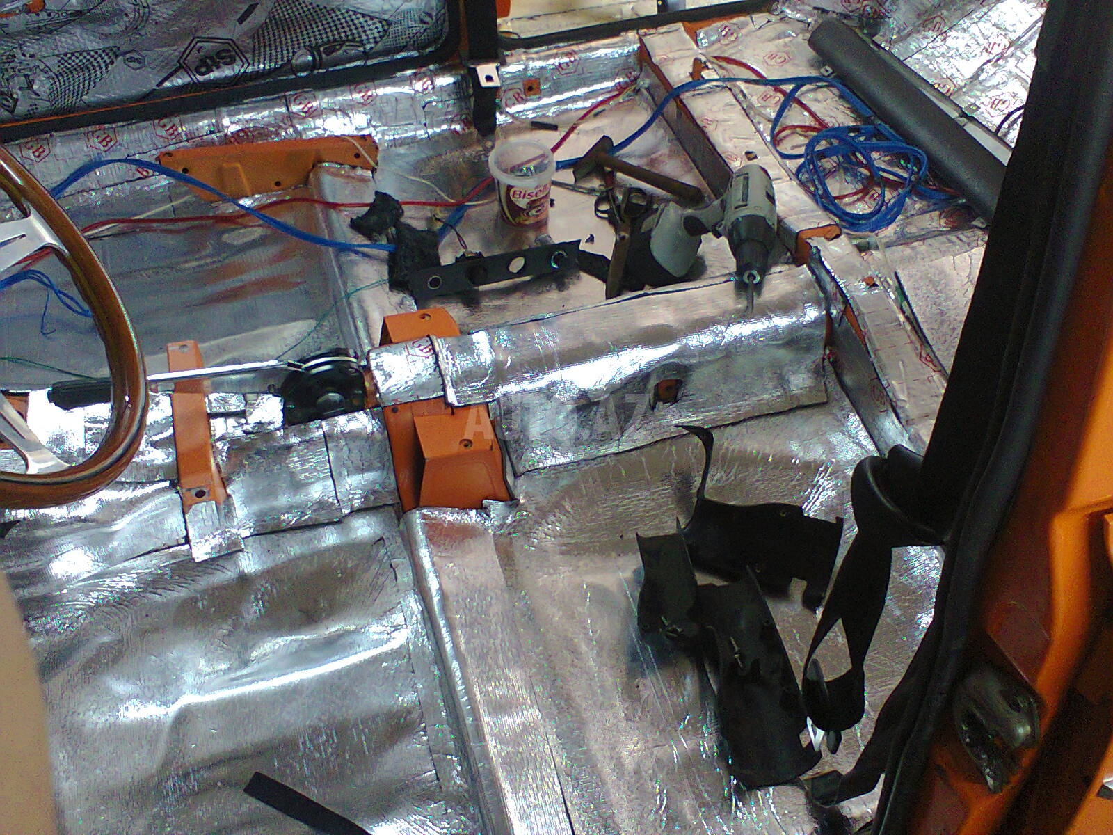

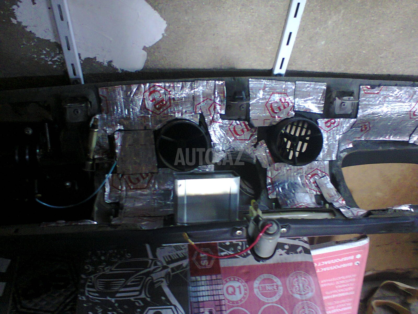

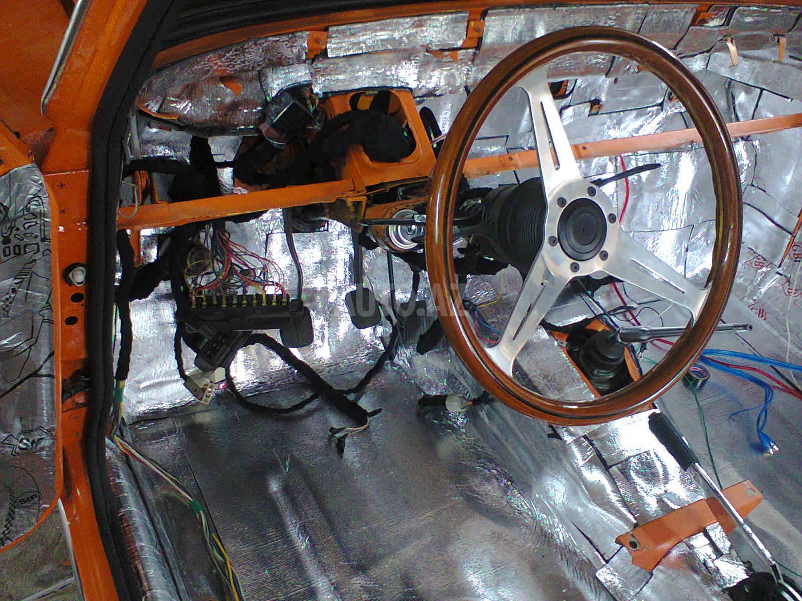

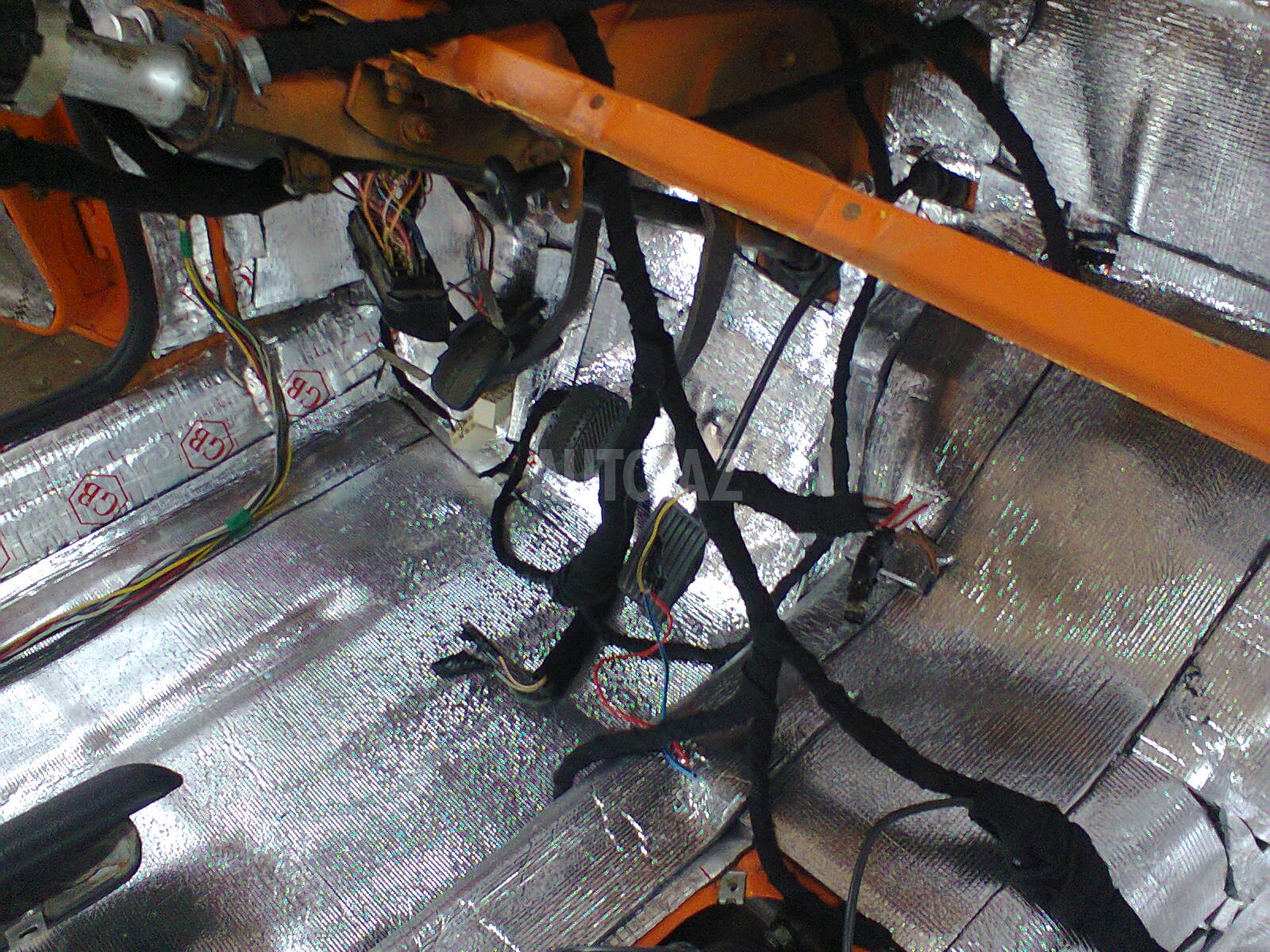

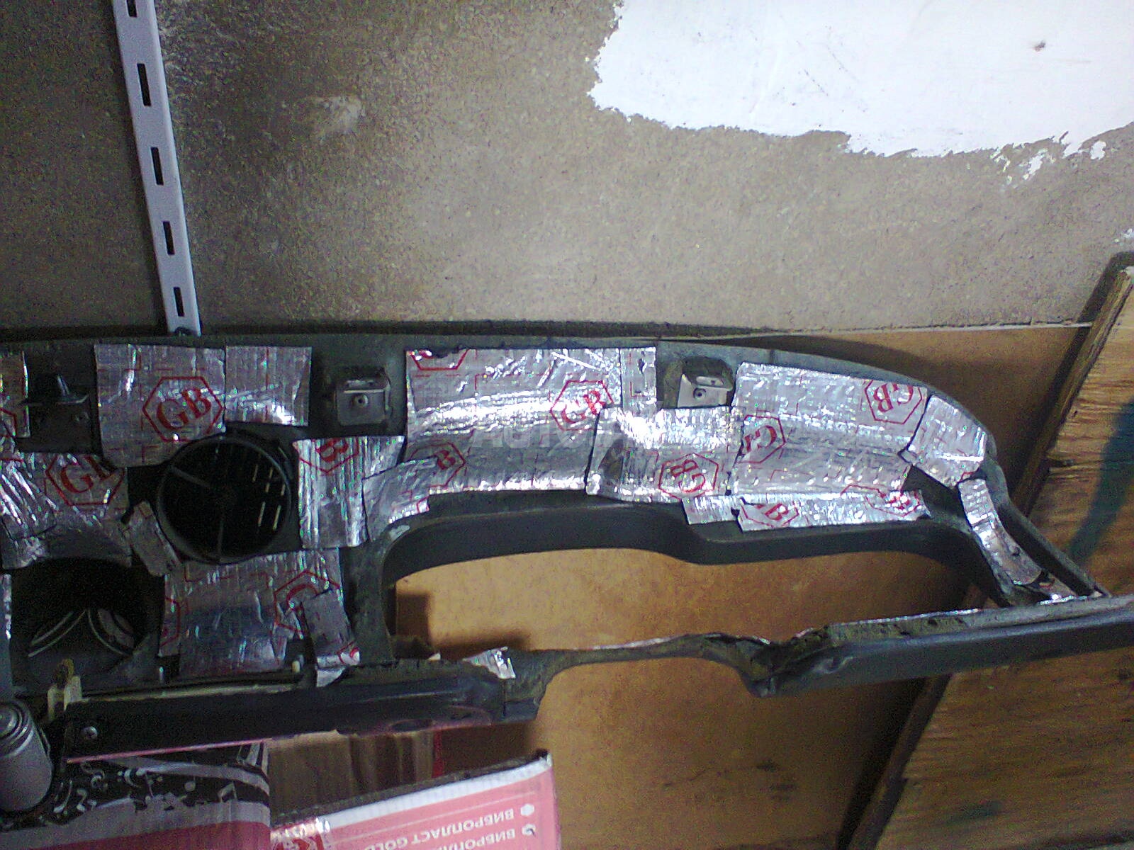

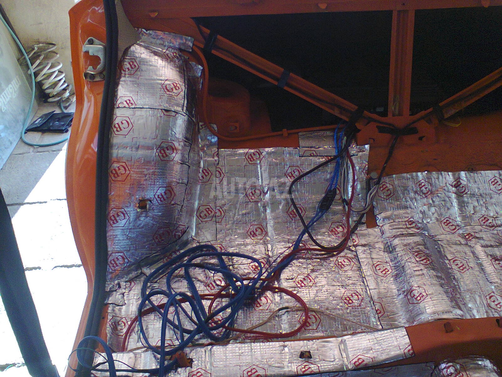

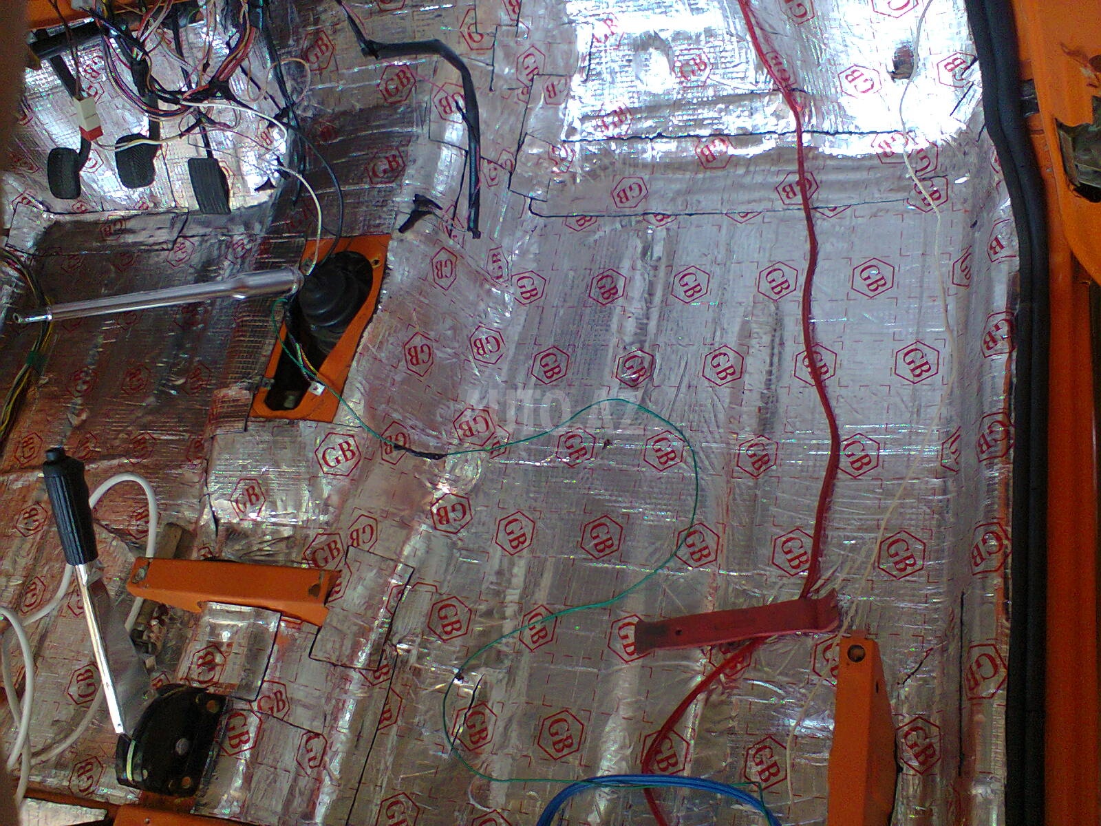

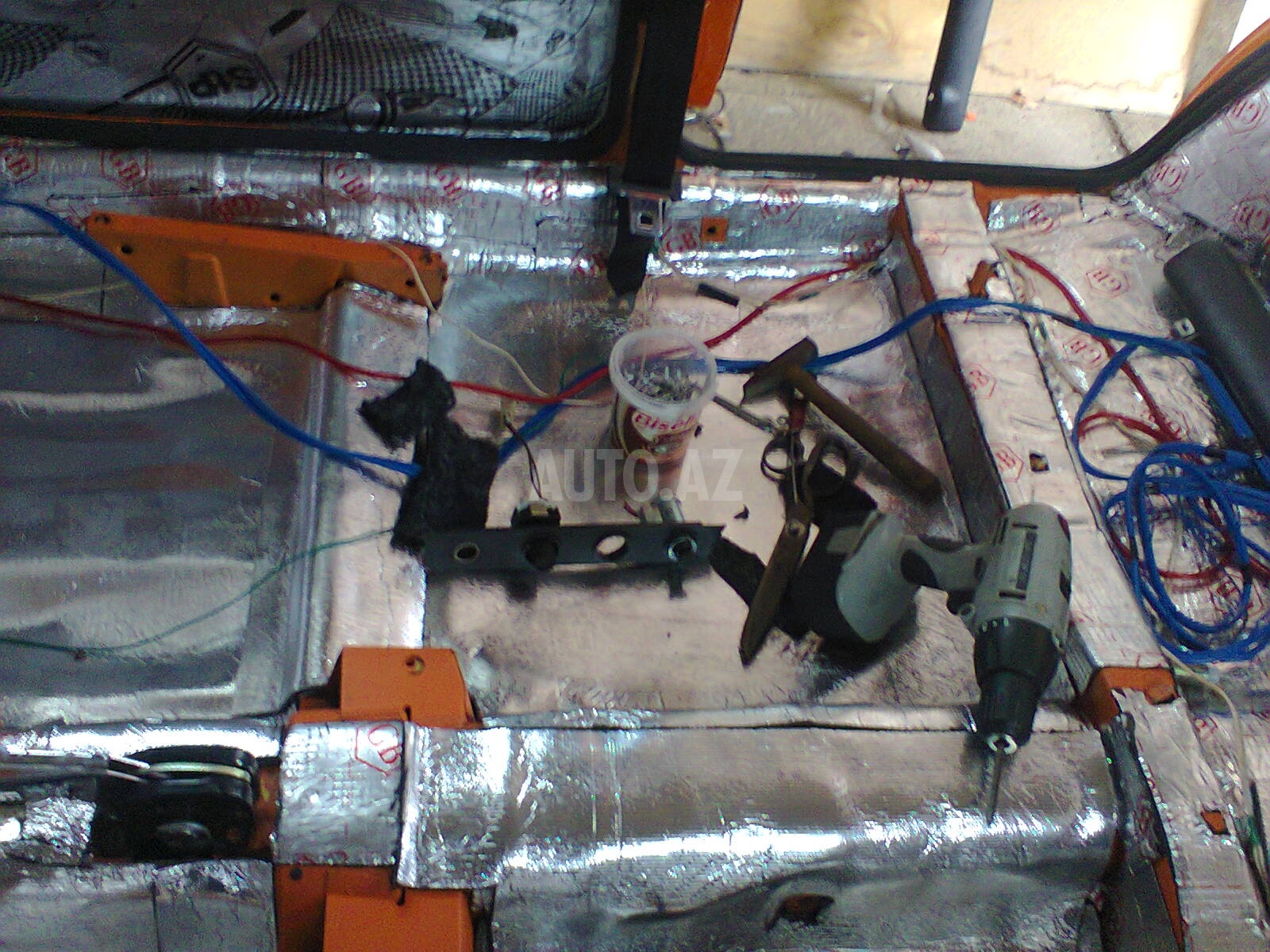

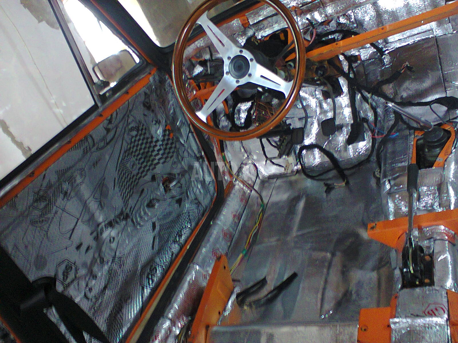

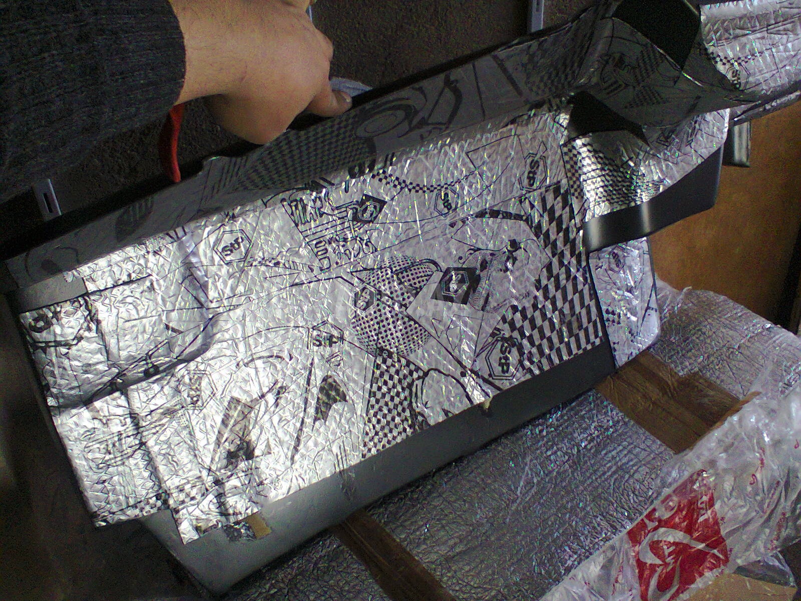

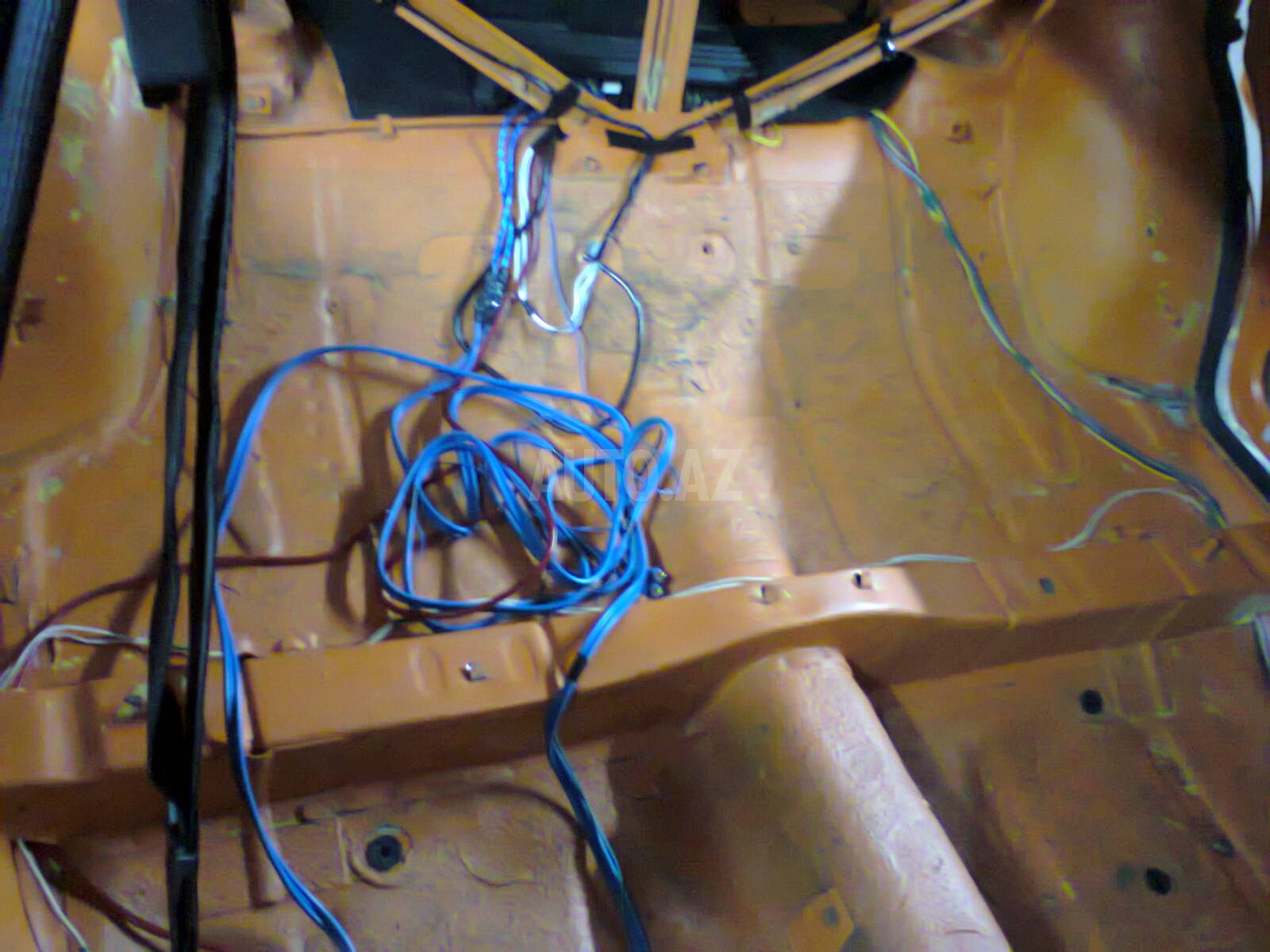

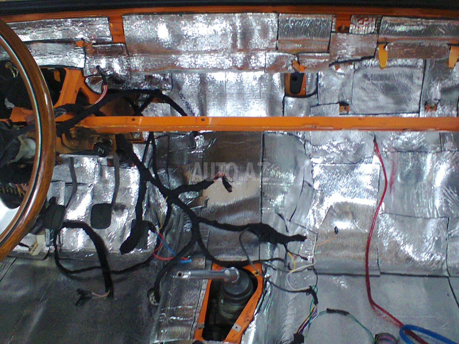

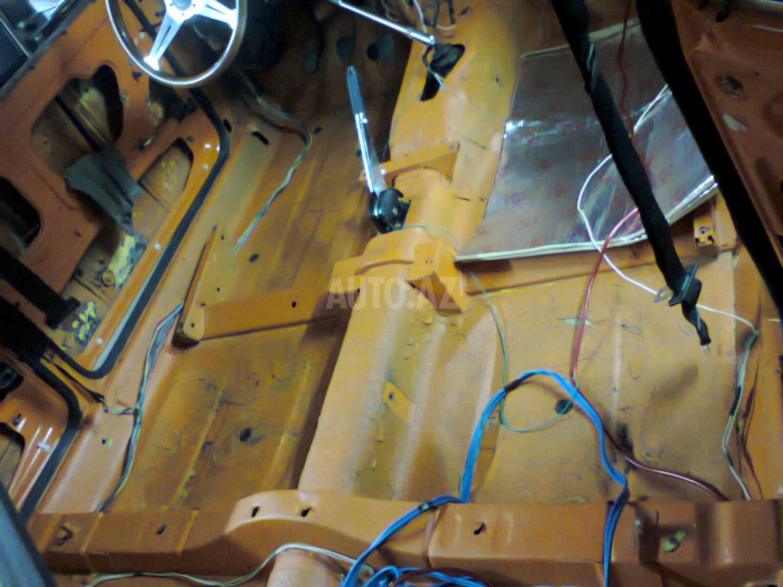

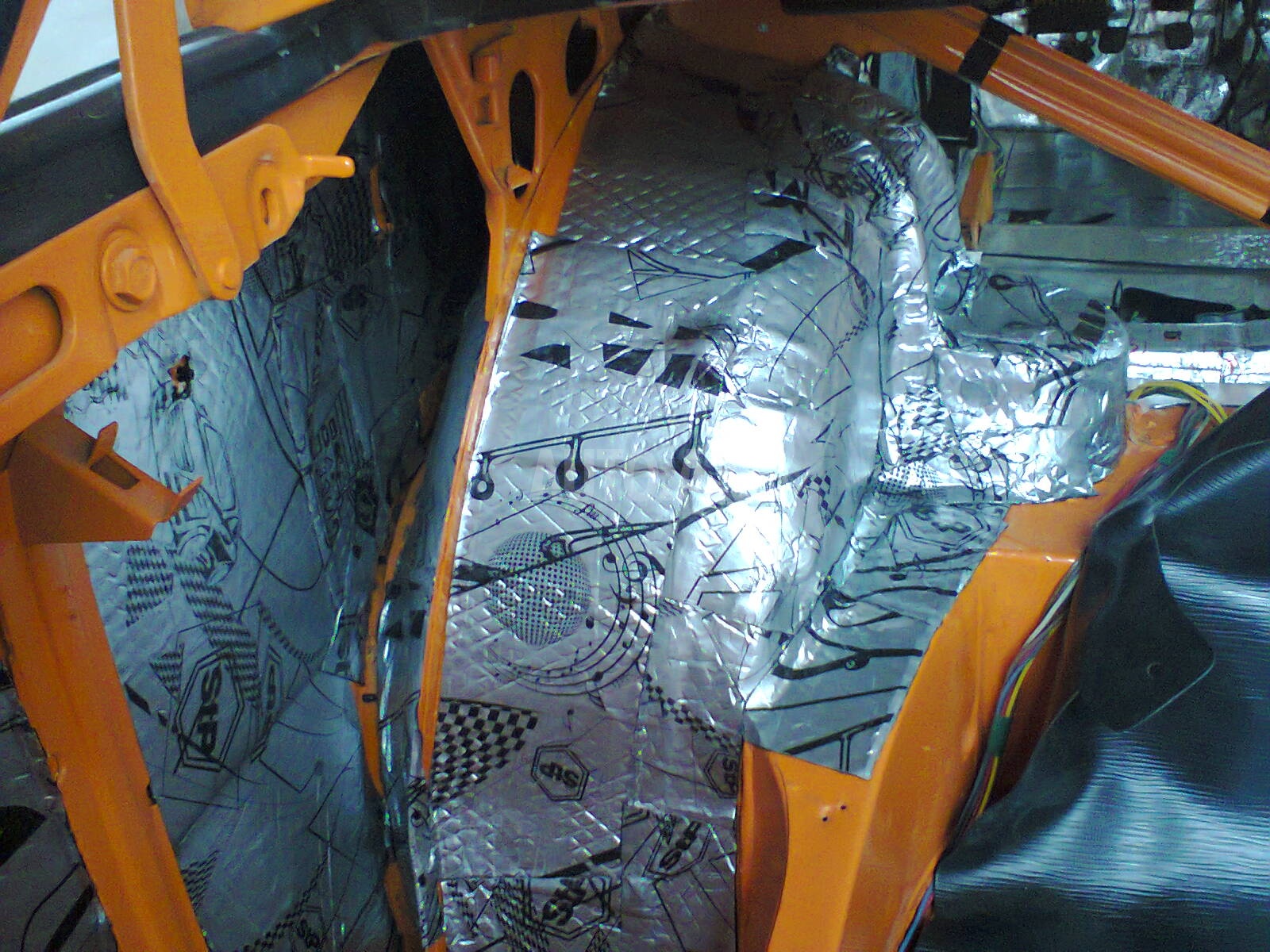

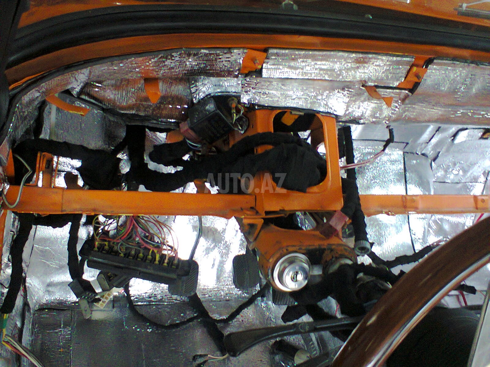

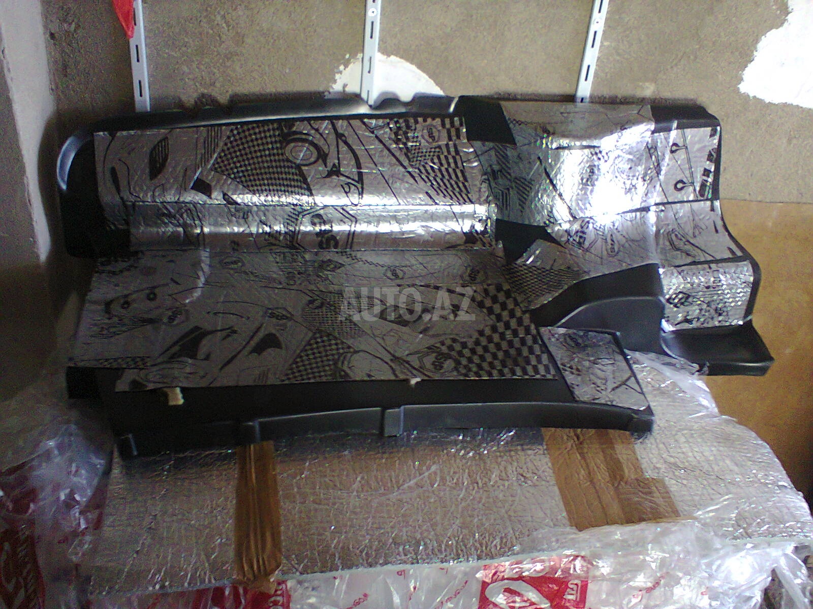

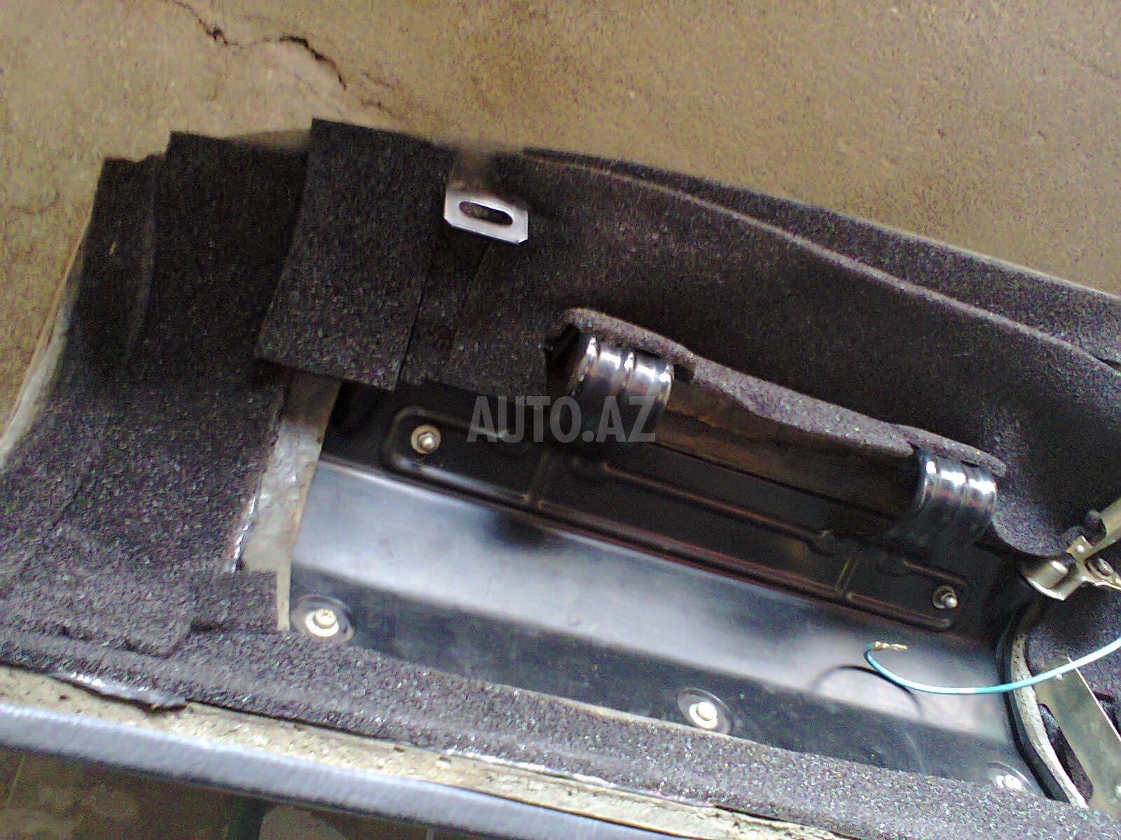

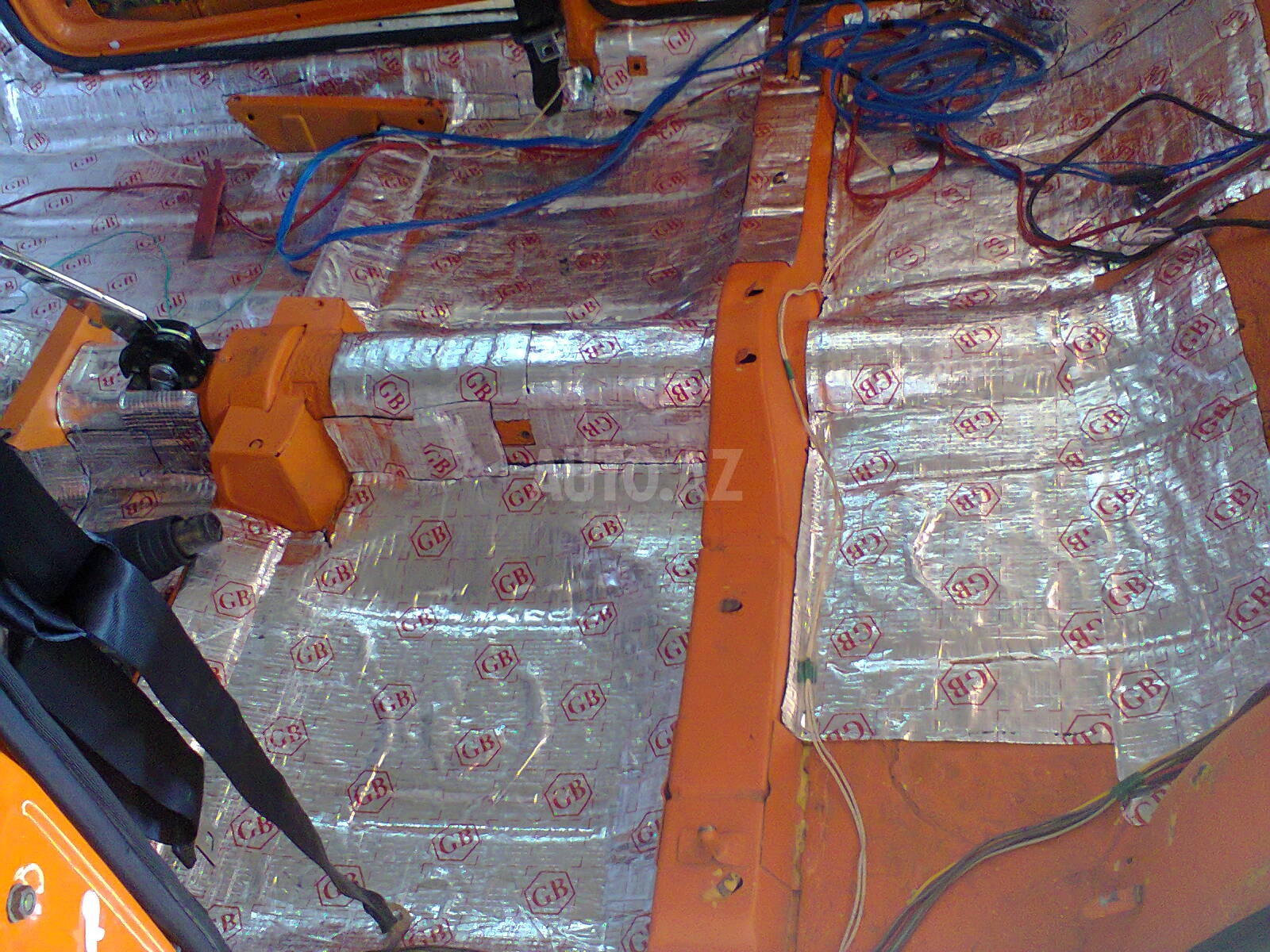

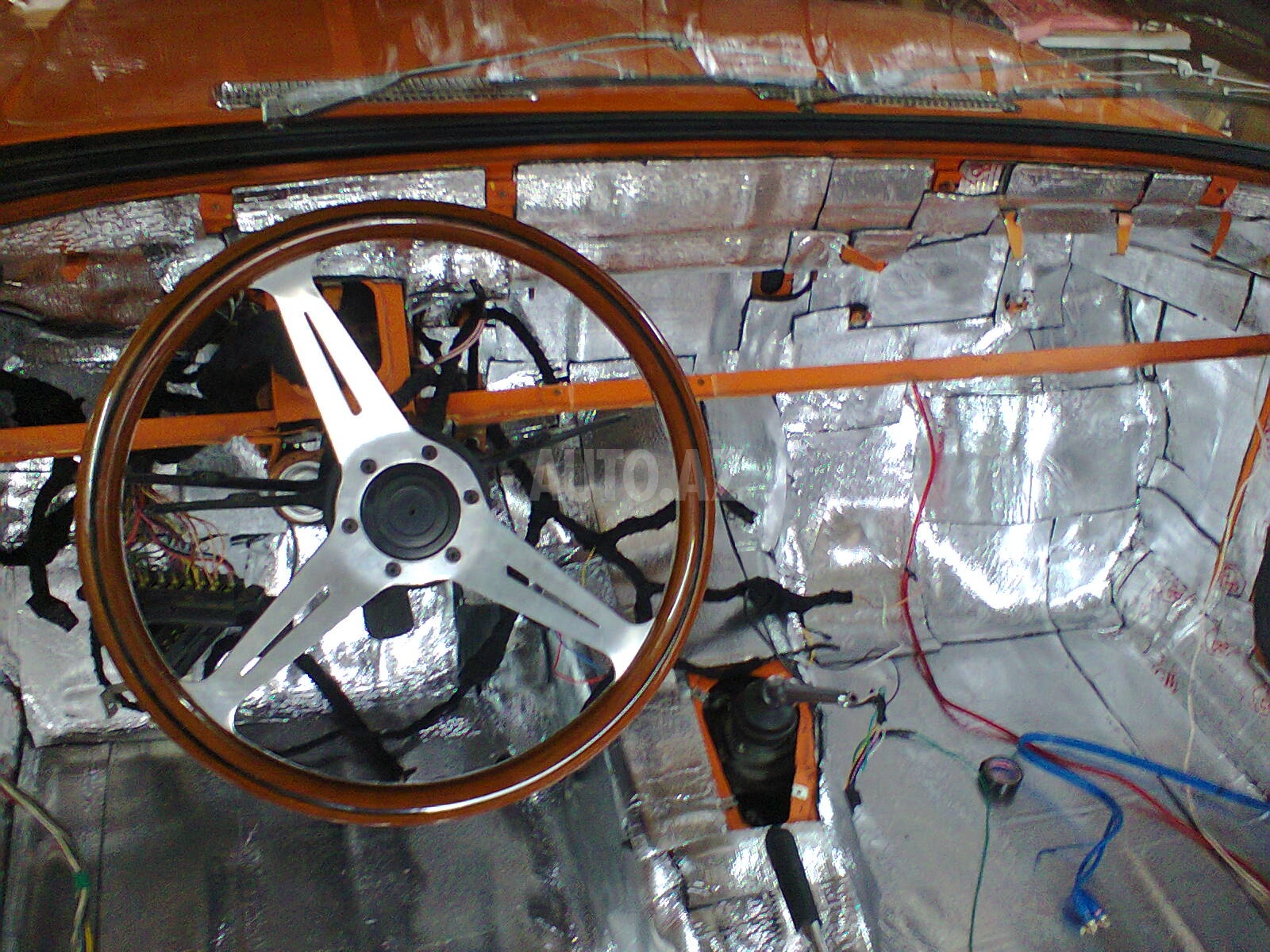

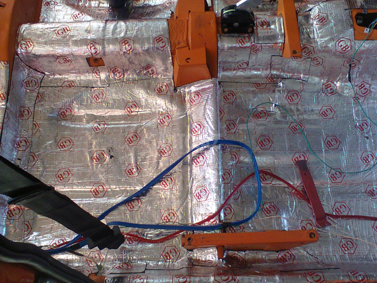

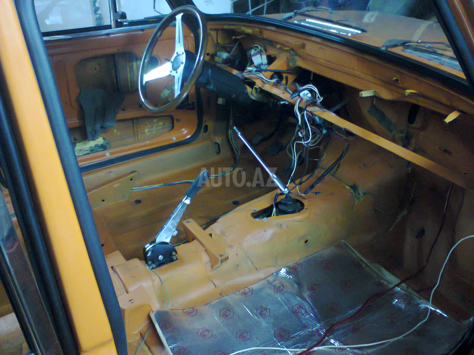

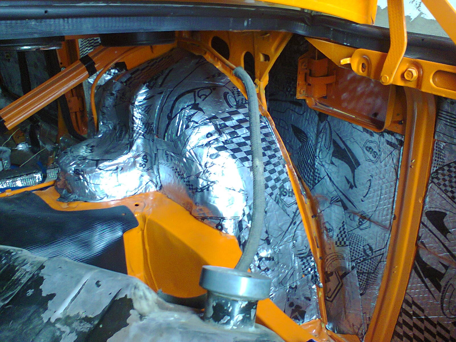

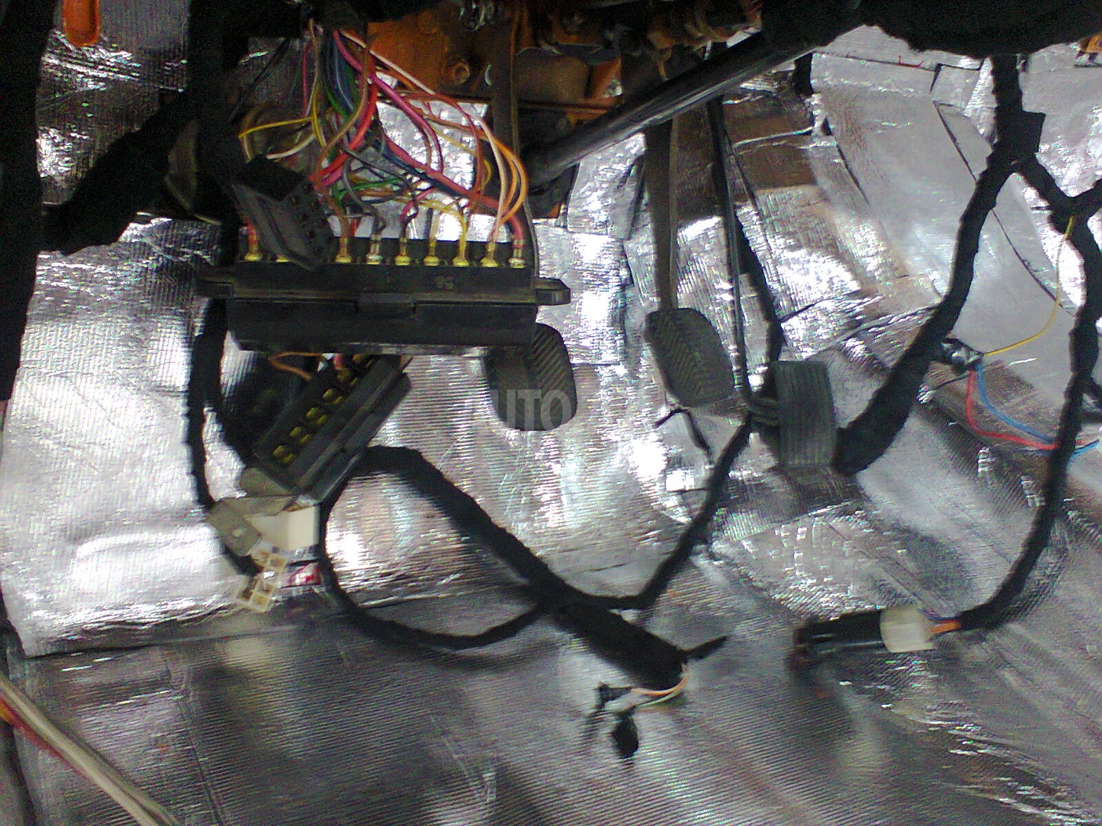

Obeshumka Zbor salon STP-ile-Vaz 2103.
Salon obeshumka olunub hazirdi,butun qapi ruckalari acilib sokulub,yaglanib,bezwumka olunub.
Pol,Sine(Mator hissesi) STP Silver+Spleen 3004.
Qapilar 2 sloy STP-Silver.
Baqaj-STP Silver.
Wit(Torpeda)-STP Silver+Bitoplast 5mm.
Butun Plasmas Hisseleri bezwumka olunub.
Tok Sistemi(Pravadalar)-STP Madelin-ile bezshumka olunub.
